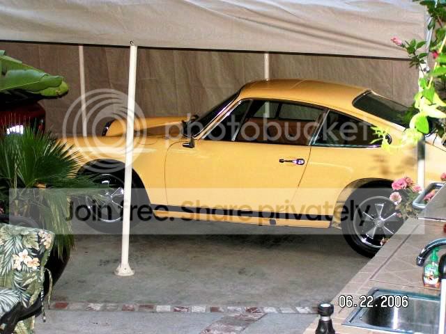

Nice work on everything......BUT.....just my $.02 but the bench looks flimsy. I'm sure it isn't but the appearance looks slight. Plus it would bug me not to have a shelf underneath unless you built it at a height to allow tool boxes to slide underneath.
Nice Mid year by the way. I had a '76 in Sahara Beige I brought back from near death. Body work and repaint, new upholstery, did a mini backdate on with Euro tail lights and the small bumper guards, chrome side mirrors replacing the flag mirrors. I kick myself all the time for having sold it.
Sorry, but this is the only photo of it I can find right now:
