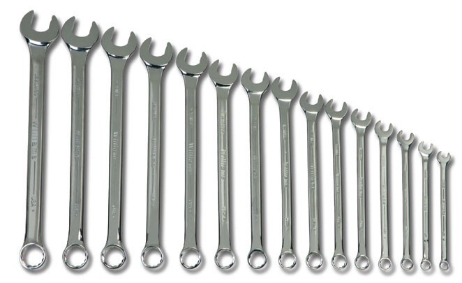

Williams MWS-15A - $160. I like that it's flank drive on both ends and they certainly appear to be high quality. Made in USA also. They don't seem to come with an organizer, which kind of bugs me, but I can do without. I know they are affiliated with Snap-On, but I don't know much of anything else about this company. They don't say long pattern, but they certainly look it.

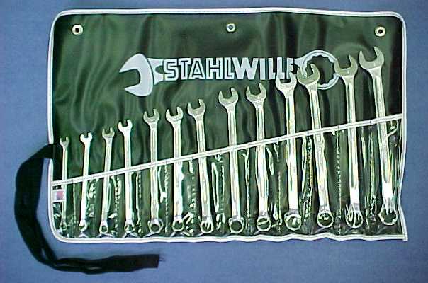

Stahlwille 14 - Expensive at $200 and technically long pattern, but they don't seem that long. German made quality.

Williams look nice. I have the sk set, they are nice but very thick. Can't stand to use the raised panel wrenches anymore.

I would get the Stahlwille or Hazet if you could find them online. You'll never break these so warranty would not be an issue. Of course, what I would really do is get a used set of Snap-on and be done with it.
I just picked this exact set, I am definitely impressed with them and appreciate their feel - wider and more comfortable. I m keeping these in favor of USA made Cman pro's, better comfort and Flank drive on the open ends sold me :p
