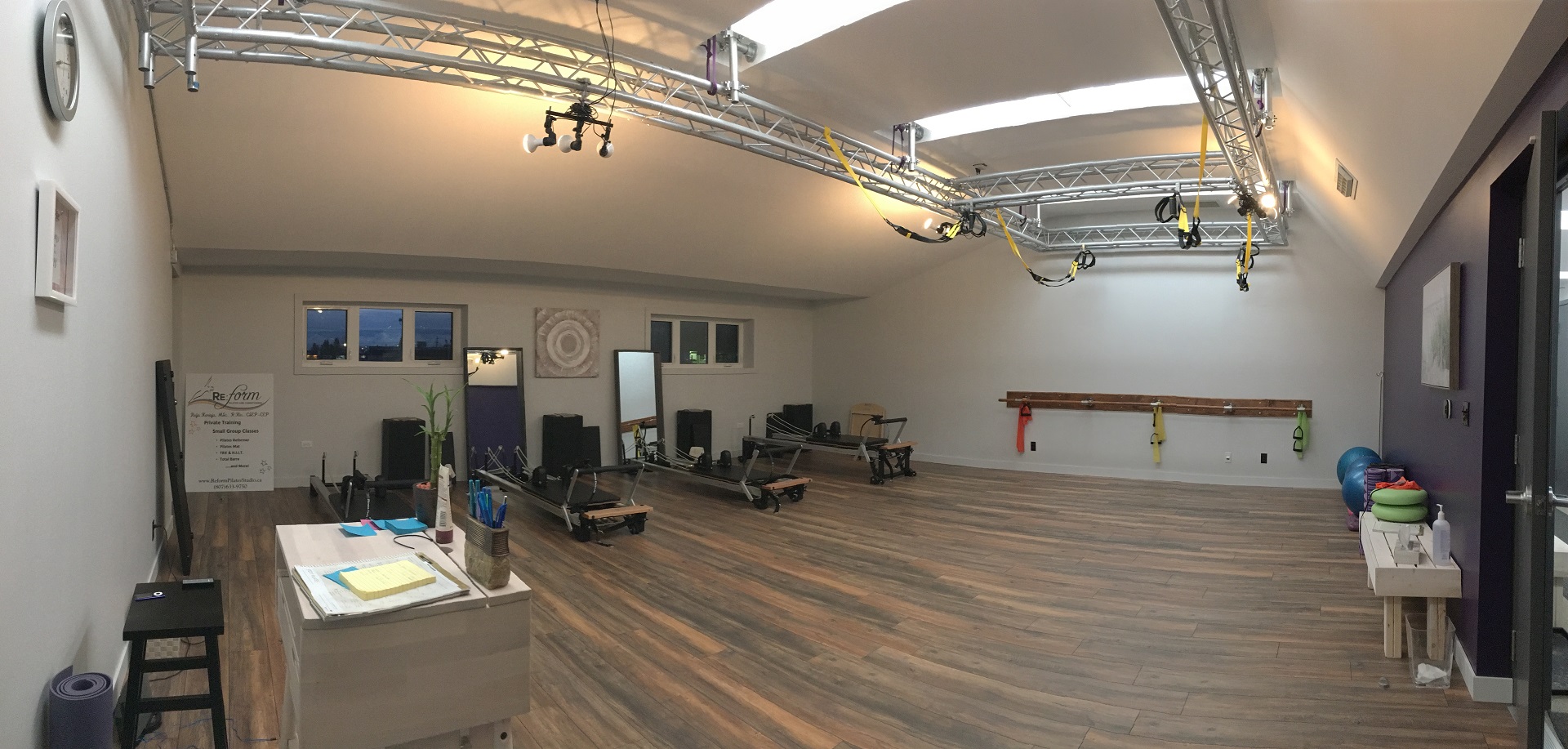

That looks like a good candidate for the restructure in place. For my application, we took 50 foot trusses and created an 11 ft vault on one side from the existing 8ft ceiling. It involved gluing/screwing a single layer of 3/4" fir plywood to both sides of the truss. We then added 2x6 material to reinforce the new the bottom chord...basically a 2x6 + Ply + 2x6 + Ply +2x6 at the new bottom chord. It's very strong as our snow load here is high.
The 2nd of the two drawings is the one we're talking about. The 1st was another mod to create a 17ft clerestory by raising a roof section.
This was the end result:
