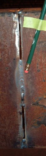

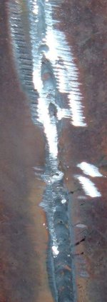

This is a plate with a gap wider than it is thick, its about 10 gage or 1/8 but a guy can really hang a puddle with these little feeders and welder right up. Faster than fussy fitting and can assist in good fusion, no way it isn't melted together.
