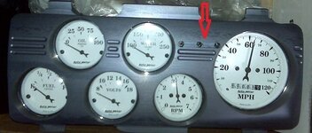

My 84 year old Ford is all LED. The high beam indicator. left and right signal indicators are LED and fiber optics. I use Pulse Width Modulation to dim the dash lights. PWM is a very common method of dimming LED lights that works by very rapidly turning them on and off for periods that visually appear as a steady dimmed light.
If you are interested, I milled the dash insert from one piece of aluminium bar. It took several hours on a manual machine. The insert fits without modifying the car. The OEM tabs hold the insert tightly.
I do not have pictures of the shop lights.
