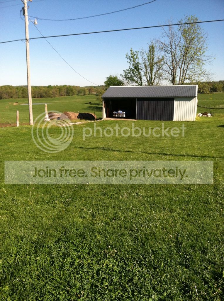

I need to get internet in my shop asap. My shop sits about 125 ft behind my house. It is a pole building with metal roof and siding. My wifi signal only goes about 100 feet (about where power pole is shown in photo below). Each building is on a separate meter service. Cat5 in conduit is a last resort option. I have done searches on this topic, but I'm not sure what exactly I need or where to mount them. Any help is much appreciated.
The shop

It is pretty straight forward ; if you don't want to do a cat5e get the following..
Two of these: http://www.amazon.com/dp/B004EGI3CI/?tag=atomicindus08-20
These will basically operate as a wireless cat5e cable. You just need line of sight between the 2.
From your Internet router in your house, you need to run a cat5e cable out to the location you mount the CPE. In the shop you run the cat5e cable from the other CPE to either a switch or just one of the AP I link to below.
I am shipping over stuff like the poe injectors, but it is pretty simple stuff.

I understand needing the antenna... but where would I place the two nanostations? One at the back of my house and one at the garage? Do I need to place one on a pole out in the yard? I can't figure out how they work and there's not much info on them on the internet.

Basically, just line of sight. They need to be pointed at each other with no obstructions in the way.

His shop is on its own meter, so power line devices likely won't work.

Here is a quick and dirty illustration...
Beemer533
May 9, 2014
2,057
Syracuse, NY
Actually, here is a much better illustration than mine..
