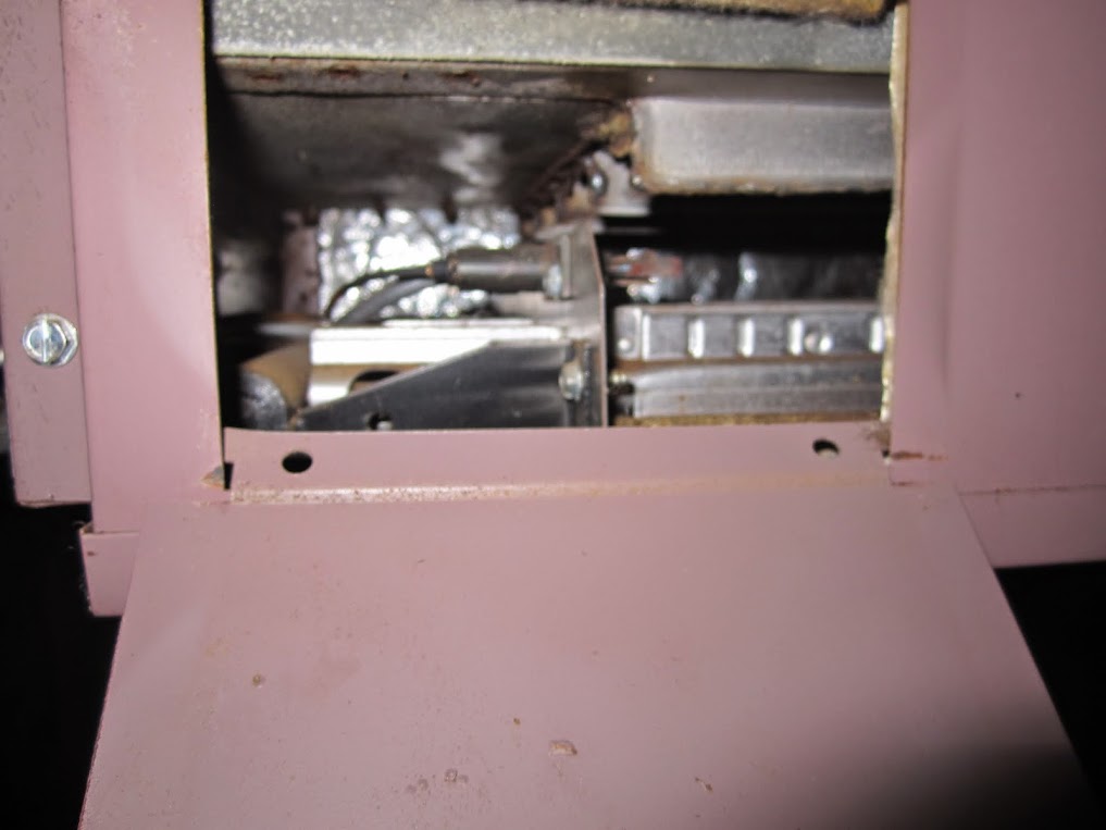

My wife and I recently moved into a new (to us) house and I got a great shop space with a detached 2 car garage. As it's getting colder, I'm motivated to figure out the heater that's in there. I can't seem to get it to work, with just turning on the breaker (the line is hot, I tested it), turning on the gas valve along the black iron supply pipe, and turning the thermostat up.
Here are some photos. Having trouble finding info about this heater online. Any help would be appreciated.

it looks like the gas valve & the back of that heater has been getting wet, perhaps from the flue . I would recommend getting a gas guy to inspect it before you run it.
Oh, and it's a standing pilot ignition, you need to light the pilot to get it to work...
but, again, I would have someone3 look at it first

Does the blower motor kick on like its trying to light. It should kick on and you should hear click,click,click, which is the ignitor. Unit does look pretty rough.

doubtful it was a professional install ... to many things that don't look right. no drip leg on gas line, black tape instead of marrettes, flue to close to flammable surfaces ,

It's old, standing pilot and I think I see a couple disconnected wires hanging down. It's old enough that the serial number lookup on the reznor website won't work, I would call reznor and see if they can get you a wiring diagram.
If all the wires are hooked up then try lighting the pilot and firing it up.

Those old Reznors were pretty solid unit heaters back in the day.
That one is a natural draft unit that has a power ventor motor added to the flue gas outlet.
Now that looks like it is a factory option but it looks like it has been thoroughly screwed with.
If the heat exchanger is solid you may have something to work with but you might be a few hundy into it before it makes heat for you.
I would be worried about the stretch of vent piping that is under positive pressure from the ventor motor/fan too.
The moisture might be from the products of combustion cooling and condensing in the unit or vent piping.
A new low profile unit heater might be a good thing to consider.

So the genius who installed it obviously wasn't too particular. Among other things, you can't see that the flue pipe exits from the siding on the garage through a pretty sizable hole with no flashing whatsoever. That's where the water is coming from, so I'm not so worried about the furnace itself generating a bunch of moisture.

you may not find a wire diagram for that heater, if the power vent was added, after the fact there will be a sensor that will not let the heater fire off till the power vent is running, is the thermostat hooked up and working? i see too many wires not hooked up like the red and yellow by the fan
