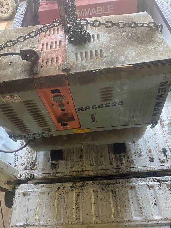

Well being a sucker I bought it. I like how the ad just said it was dented during transport and it works great. Good thing I just wanted it for parts as there is no way this thing could have ran. It is all the original parts but it is beat up. The pressure switch was snapped off, cooling fan destroyed, oil cool fins are damaged, the direct drive coupler damper is shredded and power switch is missing.
I think it has seen less use than mine as the oil is much cleaner and oil separator filter isn't rusty. I mostly wanted it for the motor and pump as I'll never find those. I'll try selling the tank to get some money back.

Gee, for my first post ever on this site, I have to bring this back from the dead. I am looking at one of these things that has the wiring ripped apart, but turns freely. Then, much to my surprise and delight, the OP is somewhere near me!!!
Will PM him and see how this goes. Yes, I found this site doing a search for Newman 55S25 information.
