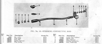

Nice drag link bit, catron. That is the smallest (exactly a 47/64" blade width) of a 1/2-inch drive three-bit set that every WWII mechanic had in his GMTK, used to adjust the threaded ball spring plugs on the ends of drag links, tie rods, etc, in various size trucks (hence, various size drag link ends). The others were a 15/16" blade width (Snap-On A-17) and a 1-3/16" blade width (Snap-On A-15). They're appropriate on the end of a reversible ratchet or hinged handle or any socket drive handle you can use for turning any plug nut with a slot that you can't get a screwdriver on.
Below is a diagram of a Willys MB/CJ-2 drag link set-up. On each end there is a threaded plug that holds the ball spring in. If you have an old truck it probably has a drag link or a tie-rod or something that converts steering between the Pittman arm and the steering arm, it probably has them. Manuals differ on how many turns to seat it and then back it out a little. Or in some cases, whatever it takes to get the split pin in. :)
