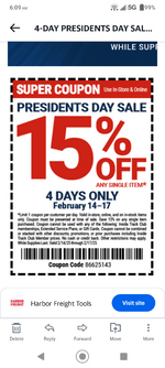

Pretty sure that 30% off coupon doesn't apply to any high-dollar items...but I may be wrong.
Sure doesn't which I figured out this morning AFTER asking the question and then went to order.
Apparently ol' Cam's eyesight goes to **** after 10pm....who'd have known.
Getting old ***** doesn't it ?
Did you end up buying anything with the 30% off coupon ?
L
LXCam
Apr 23, 2013
19,366
Why not ? You can always find something for less than $10. I walked out with an armful of mover's blankets.
Well it just was sooo much funner approving time cards, uploading training certifications some guys got over the last couple weeks and putting together a corporate business plan for my division that had a drop dead due date of last Tuesday…
It just didn’t seem like saving $9 could top it 😂
