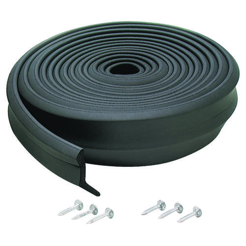

I don't suppose there is one made just for that. I actually have one here sealed at the top, and I've got a door bottom seal on it. The door bottom seal is mostly available with a round cross section, but you can find a few that have a bit of a lip on them. I used something like this and I suppose it came off the shelf locally.

Piece of pipe insulation. I put a piece on the top of my regular door since there was a big gap across the top with the door closed. I just used silicone caulk to glue it on.

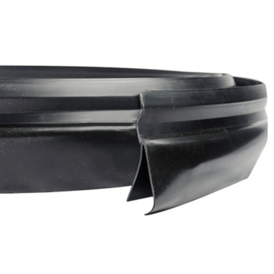

Your problem is not an uncommon one. It can actually happen with standard lift doors as well with windows that protrude from the face of the door (or trim attached to the face off the door). You can try pitching the high lift insert back more (back in the day installers used to have to actually make pie cuts in the track of doors that they put trim on for the trim to clear the weatherstrip/door opening). That may require taking an additional cut at the bottom of that insert. The door will not run as smoothly through the transition, but it may help your problem. You do actually have some space between your window and the trim (in some instances I have seen that trim basically lock the door shut because when the door closes it ends up literally just above the window frame).
Yes you could cut the flap from the top weatherstrip too (sometimes replacing with a new more pliable piece helps as well). They do make top seal that is designed to attach to the top of the door. It is most commonly used by commercial door installers. It is available to purchase online as well as it can be rolled up in most instances for shipping.
There are many different versions of this, but it attaches to the top of the door and seals against the header.
I hope this helps.
