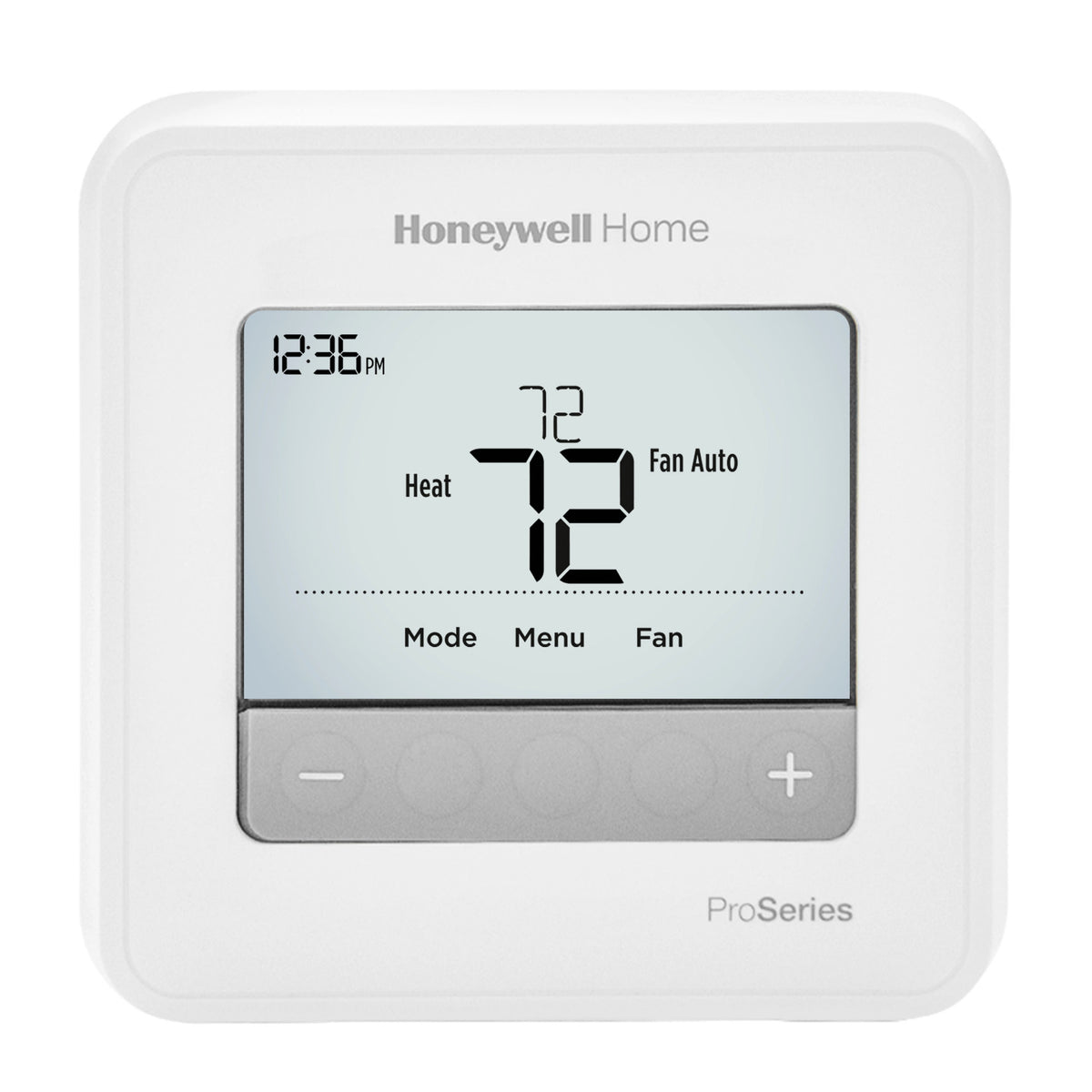

Digital thermostats (programmable, non-wifi)
Programmable thermostats came out right after I started doing HVAC hard and heavy, and they were the "new" thing, so the boss investigated them. He settled on Maple Chase for his entry level stat, and Honeywell's Chronotherm 3 for his deluxe model.
The HW had this mode called "Adaptive Recovery" which would learn the building it was in for a year, and then automatically make temp and time adjustments to meet the programmed setting but save some run time. If you kept manually changing the settings it would mess it all up, but - if you left it alone - it would adapt to your schedule and save money. As much as 17%. Groundbreaking at the time, but pretty commonplace now. With the advent of Wi-Fi stats most of these older styles have been discontinued. But a few are still available.
When I started my business I was given a Braeburn digital stat - salesman said if you like it you'd buy more. I loved them! Really liked the feature of being able to replace batteries from the front without having to take the stat off the wall. I carried one model that would cover 75% of the applications I ran into - so it reduced inventory. Braeburn has change their design, and their quality is not the same. But they're not bad for what they are.
So in my house I've installed the Honeywell T4 Pro. Can be run off of battieries or a common wire. After a year it's been OK for me.

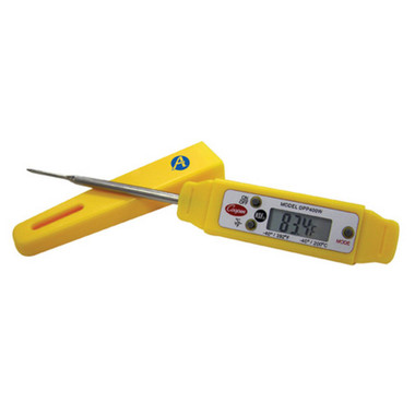

I'm not a total fuddy-duddy when it comes to new technology - I just don't jump on the bandwagon until the tech proves itself. With pocket thermometers it was advantageous to have a faster response time. But - since I worked on evap coolers - I kept dropping them into the water, ruining them. They didn't like sweat much either, and if the batteries weren't watched closely you'd be buying another thermometer soon. All that and the cost of them back then made me just give up and go full analog for pocket thermometers. But brands increased and costs came down over time. Epstein had a sale on some pocket digital thermometers a while ago and I bought a handful. They are my regular use ones now.

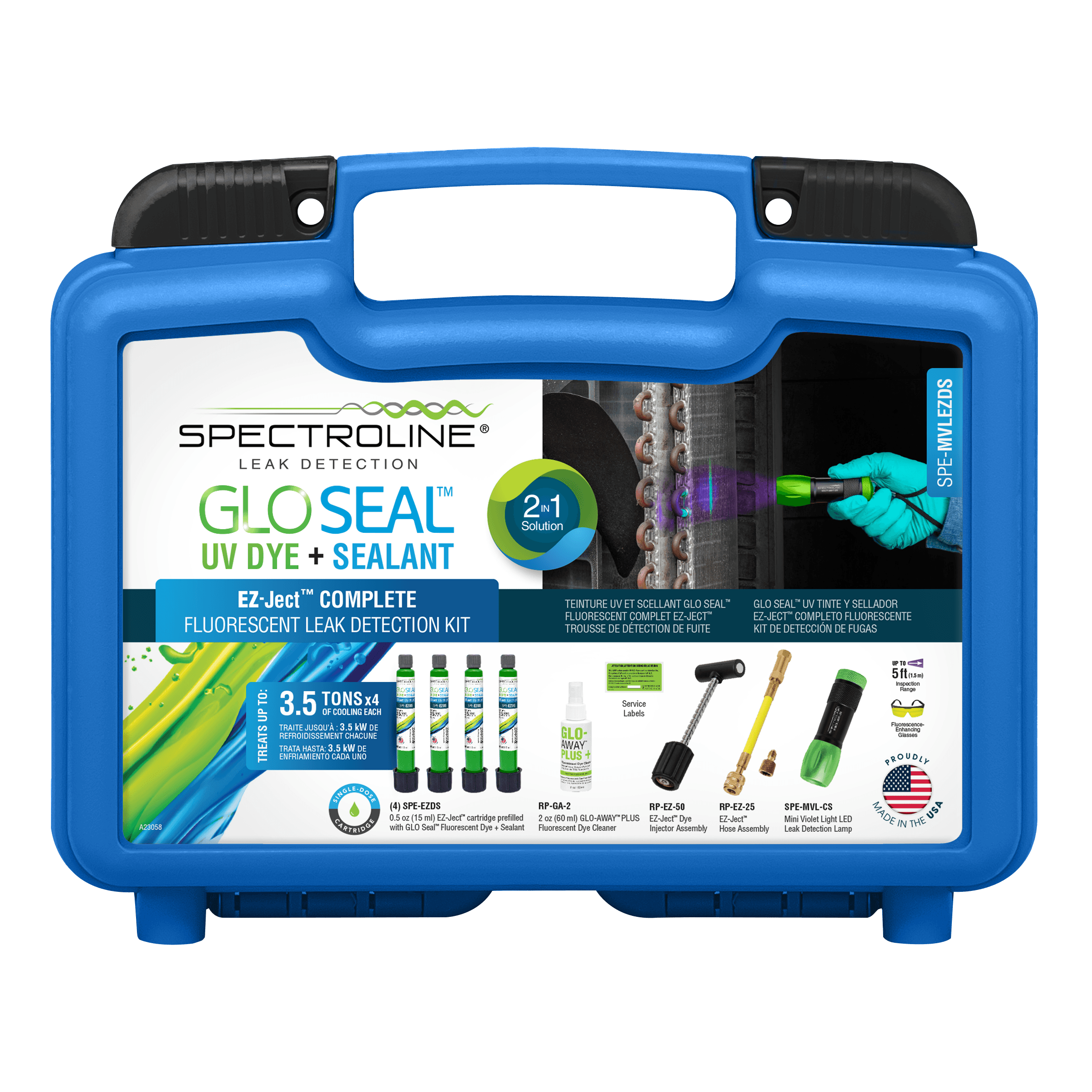

A/C leak check ideas
There were sonic detectors, and several different types of hand held electronic freon detectors I've used over the years. But honestly, I've found more leaks with soap bubbles than any other method. Plus, I could use it to clean my hands, clean up grease and oil spills in the truck, and - when massively diluted - clean condenser coils. (Dawn Blue dish soap was my preferred brand). But at my last paid job the guys were using this new stuff, and I ended up buying a bottle just for the heck of it. https://www.refrigtech.com/big-blu/
Though this yellow stuff is definitely been around awhile - and works on any refrigerant. It used to be this bright yellow just for visual bubble detection, but now apparently is UV light reactive - so that's an added bonus if you have a light.
I looked into the injectable dye leak stuff when it first became available but was told any freon tainted with dye wouldn't be accepted for reclaim and recycle. So I didn't use it. Though on my home unit recently, I used some and couldn't find any leaks in the system - then found a broken schrader cap seal depressing the valve core when tightened! Ugh! All that hassle, but I now have peace of mind.
