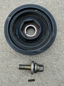

{snip}
I’m not shopping for an impact but I think this class of tool, which can be a major investment for many, should have some situational context for both the thread starter seeking advice and the kind folks giving it.
Not only that but I'll tell ya in this situation electric affords WAY more trigger control for both "bumping" that joint in a little more or not spinning a mile away from the work when backing out.
But here, you want Max Power (Great name! .... "Thanks I got it off a hair dryer") so if you intend to use a bj press, high torque all the way.

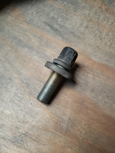

You'll need the high torque for Honda/Acura crankshaft bolts because mid torques can't break it free.
I had luck with a harmonic balancer (i think it's called) socket on my mid torque. The extra mass of the socket puts more energy directly into the bolt. My impact is 600ft lbs on high and got it with little effort.
