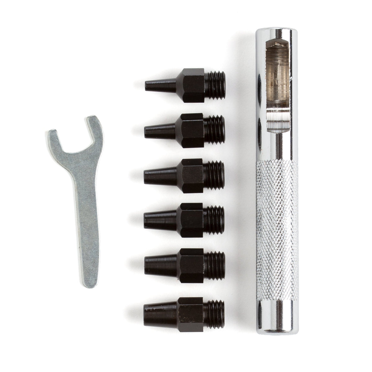

I am looking for a manual hole punch set(hit with a hammer kind) to make holes of different sizes in thin rubber, cork, plastic, leather etc. In the past I used spent bullet shells but they don't last long and not the correct size. The hand ones that you squeeze with the wheel are junk. I am making gaskets and spacers and need clean holes for the hardware to pass through. Drilling is not a option.
This is just for my personal use. I don't need a Snap On or pro set. Any suggestions?
Thanks

I realize this is not a hammer type and if it isn't what you are looking for, just disregard.
I use this Roper Whitney, which is very well made, though it not cheap. It has sizes: 3/32, 1/8, 5/32, 3/16, 7/32, 1/4, & 9/32.
I have used the same punch and die to punch hundreds of holes in 2 1/8 deep electric boxes with little or no signs of dulling.
Amazon Roper Whitney Punch

It is not just for metal, I have also used it for thin rubber, cork, poster board, and leather, which was mentioned by the OP, along with spent bullet shells, which is similar to the punches provided with this tool.
13,499
oohhh, so that's the key I don't have with mine. Knew there would be something easier than my stubby screwdriver. Used mine over the weekend, with 4 different punches, only downer is the distance from the edge. I had to rotate the tool to get to a few holes. Tho none of the hammer punches seen so far in this thread will go through a saw blade.
