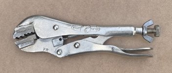

This stray cat followed me home. It is a modified 7R. Looks like it was used as some kind of crimper, with the wingnut being used to adjust the final opening.
Markings are:
Petersen/Dewitt-Nebr. USA/Mfg. Co. (<-in the typical logo) -
Vise Grip ® (<- in handshake logo)
7R
Vise-Grip
® (<-on handle)

Nice welds!

Vise grips are a great starting point for custom tooling. I've added a nut to the adjuster for repetitive tasks. It's a handy addition, but there isn't much clearance at the small-opening end of the range.
Those look like a shop-made example of these.
@Mintgrun, The Easton panel flanger has smooth faces. Mine has splines on one of the jaws.
Only one way to confirm if mine would work as a flanger without creating spline impressions. I pulled out some sheet metal and gave it a try.
It worked perfectly.
Thank you for the identification! I never would have figured that out.
