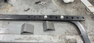

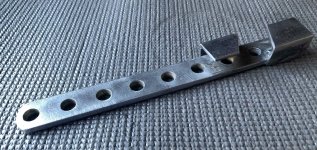

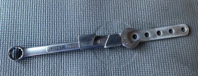

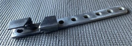

Yesterday, I made a wrench extender from a piece of garage door opener steel and angle iron. I saw a few on GJ and decided to make one today. God willing, I will become a better welder some day. He is good.
This place is a bad influence.
As for the welding….
I worked with a guy that would say “ A grinder and some paint make a welder what he ain’t” .
