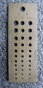

My father made this BA thread gauge out of 5/32" brass when he was in the Royal Navy either in the 1930s or just post WW2.
For each size from 0 to 10BA there are clearance and tapping sized holes and a threaded hole.
I have used this tool many times and think of Dad each time.
