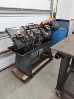

Ultradog MN
Jan 20, 2024
750
Twin Cities
Get a Johnson.
800 lbs, quiet, cuts 10x18, set it and forget it.
And everyone likes a Big Johnson.
