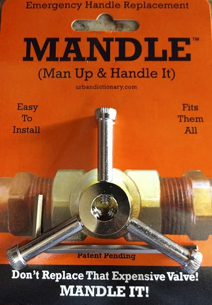

http://www.mandlehandle.com/
or put one of these on, turn the faucet on with some pliers, and leave it on
