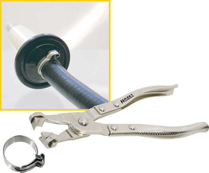

I really hate these things. Can't get them off, can't get them on.
I found these Facom or Hazet pliers in a video on youtube and they seem to work great.
Has anybody ever worked with these of a model like these and what's your opionion? Are they useful?

That's the first time I've ever seen that type of clamp. I wonder what the name of them are. It looks like you've already found your tool.

omg!!! I run into those clamps all the time on BMWs... I never knew there was a tool for those... they are a royal pain without a tool like that.. where can I get it?

I've also heard them called Oetiker clamps. They are one-time use clamps, and actually work pretty well as long as you have the correct installation tool. I use a set of diagonal cutters to remove them.
As far as replacing them with screw clamps, there are some places in the engine bay where a standard hose clamp will not fit. Also, I have yet to see a CV boot that is not secured by one of these.
These two pliers are made by Knipex:
Oetiker 14100083 Side Jaw Pincers (formerly 1099)
Oetiker 14100082 Standard Jaw Pincers (formerly 1098)
After you crimp the clamp make sure that there is a 1mm or less gap between the pinch points.

They look similar, but if you guys watched the videos, those are not Oetiker clamps. They are reusable.

I have these clamps on my 2008 Grand Cherokee. To replace the diesel fuel filter, I have to remove one or two of them. I bought a pair of 'ClicR' pliers. They weren't cheap, but do the job very well. Considering I use them only about every 18 months for a fuel filter change, I probably could have muddled through without them. But like most on this forum, I am a tool hound.
http://www.ebay.com/itm/HOSE-CLIP-C...ic-R-type-TYPES-CLIC-AND-CLIC-R-/170810795865
Here are the Clic-R, removable clamps...

Looks like you might be adding a second Facom tool to the kit.... hehe..!
Sorry I can't add a link but check out ultimate garage for Facom clic type hose
clamp pliers. As has been pointed out these are very different to band clamps
which are not reusable and generally used on CV boots.

I've seen these used on older land rovers. Once you get used to them they're much nicer because you don't have to get new ones. I use a pair of long flat needle nose pliers and then pry with a small pocket screwdriver to remove. Then I use the same long flat needle nose pliers to squeeze them back together.

Some of them with a similar design but made with a continuous lop of metal, are one time use, but if you watch the video, these are clearly meant to be reused.

25 bucks isn't too bad for a pair of pliers that saves you a lot of grief. I'd pick them up if I was in your position.

I work at a Benz dealer and run across these click style hose clamps all the time. I first purchased a straight pair of pliers as posted above but found in most situations you could not get a straight shot at the clamp. I then ended up buy a pair of these Facom ones.
They have three positions that allow you to find the best angle of attack. I also purchased a Hazet pair that the jaws swivel in any direction.
