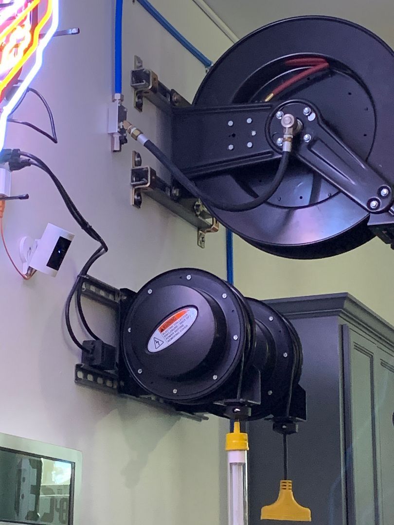

Been happy with Reelcraft
FBF05924_AB46_4FF1_B05E_CC3E4E97083C.heic
