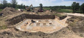

Plans changed and I am doing a basement now for simplicity and efficiency reasons. Started digging yesterday.
Open to suggestions on weather or not I should put in floor heat in the basement slab. Basement ends up being about 9’ down from grade. The piping and insulation will cost me about $3k.
It will still be an icf build to the trusses.
