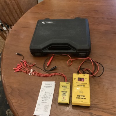

Unitest wire sorter...if you run wires or deal with wire bundles this is the toy to have........

Unitest wire sorter (or equivalent)...if you run wires or deal with wire bundles this is the toy to have........
