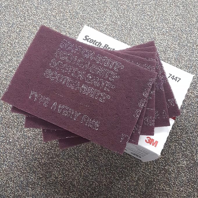

+3 on the random orbit sander or polisher with scotch bright pads ( grit based on rust severity) and lube or solvent of your choosing like WD40.

The regular 3m pads will “hook on” the hook and loop pad on the sander/polisher and they are available in multiple grits. Gray, maroon and white are the common grits. White pads are the fine grit and have very little abrasive and are more like 0000 steel wool. The pads can be used by hand.....just more work and less polishing effect.
