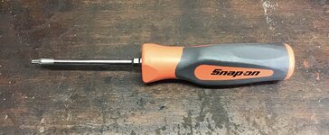

I’ll stick to the better ones, which for most folks probably start with the “Megadora”. The Snap On equivalent would probably be the “Instinct”.
These are actually very similar tools. Both have a “multi component” handle, and when you cut through all the bull about ergonomics, both use a lower density material with an overmold, I think one can safely assume as a cost cutting measure.B5B693BF-6F29-4ED1-8B17-01566A90BE22.jpeg
I won’t rate either handle as a 10/10 as both are more prone to abrasion than I would like from a mechanics screwdriver. Both feel good in the hand however, the Snap On probably giving slightly more grip, the Vessel easier to spin. The Snap On is easier to clean.
Blade wise, the Snap On is the better quality. Obviously nicely forged with a bolster, and superbly plated, the Snap On looks like a winner before you use it. In practice I have Vessels and Snap On’s dating from the mid 80’s and the Snap On’s have lasted better.
However… the observant will notice these are both Pozidriv’s. Snap On Pozidriv’s don’t fit as well as I think they should. I always attributed this to Pozidriv being a British thing but the same applies to Vessel and they fit superbly. Vessel thus probably edge ahead for Pozidriv, and I think Phillips.

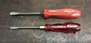

The top end Vessel’s are the “Power Grip”. The Snap On equivalent would probably be the older style hard handle, which amusingly I think was also called “Powergrip” on introduction, though that seems forgotten now.
These are slightly different tools. Vessel going for a transparent cellulose acetate handle, Snap On for an opaque material that I believe to be a DuPont. Vessel also changed the blade, opting for an obviously high quality forged blade, with a satin finish.9A0E524F-1E1C-41FA-AE45-DD4BBC4D4C0F.jpeg
Which is best. The Snap On. But only just. These Snap On handles are the best that has ever been put on a mechanics screwdriver. If you drop one they don’t crack or shatter, and they even polish pleasingly with a lot of use. The blades are, I think, the same as the Instinct, so can’t be faulted. I have seen these drivers take 30 years of daily use (not abuse) in the aviation industry and still be useable.
To be honest, the blades on the Vessels are superb as well. I think the Snap On are just a fraction ahead, but I’ll know better in 30 years when I have put both to comparable use! The Vessel handles are lovely too. Superb design and quality, so overall it’s a close thing.
