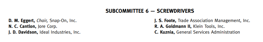

with many thanks to Brandon for digging out the original specs, we now know for sure that the ASME cross tip screwdriver standard conforms to the ISO standard, which in turn is based on the JIS spec from the 1950s, the only difference in the modern specifications being agreed (tighter) manufacturing tolerances.
It doesn't really make sense to talk about JIS screwdrivers - a screwdriver made to the 1954 JIS spec will also conform to the equivalent international specs (ASME, DIN, ISO, BSI etc etc) and all of them should be expected to work on Japanese automotive equipment of any era.
I could not find any documentation to prove it, but presumably snap-on also follow the current standards and this is why people are happy using them on their Japanese bikes and cars.
I've added the details and screenshots to my article, for those that are interested
PS the oldest US standard Brandon could find was from 1986 and it also conforms to the 1954 Japanese spec, so it seems the above situation has been true for quite some time...
BrandonV
Jun 9, 2023
4,030
Arizona
I would assume that is a given. The latest ANSI/ASME standard (along with the prior) have a few Snap-on representatives on the subcommittee.
