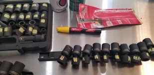

I was bored today and finally did something so I could read mine.
Great $5 to spend. https://www.homedepot.com/p/Milwauk...ERCH=REC-_-pipsem-_-206973452-_-206973453-_-N
Beer and some Brake Kleen, then the paint pen and into the sun to cure a bit. Then I cleaned the excess off with a wire wheel on a bench grinder. I hit the socket with the front side of the wheel so the bristles didn't dig into the paint in the stamping. I'm happy with the results.
