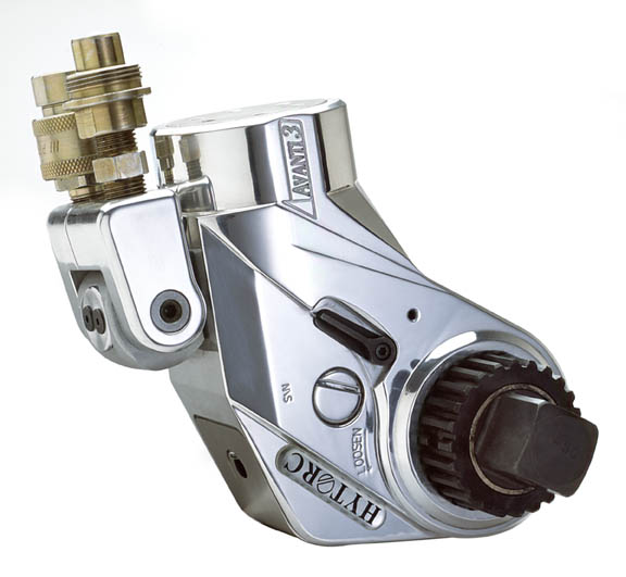

There are hydraulic torque wrenches that go to ungodly amounts of torque.
