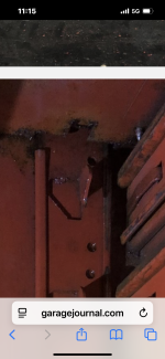

Picked up this Mac toolbox as part of an auction win a month ago, with the intent to fully refurbish and use. The drawers do not lock and the latching mechanisms in the inside back of the cabinet (see pic) do not slide up and down. The lever that is inside the top portion of the box, presumably is activated by opening and closing the lid, took a lot of work to move, which it now does. But, it does not raise or lower the drawer latching mechanism. The key lock does not look original, nor does it work. So, I guess my question is why the latches are not moving. There is some rust, and I've PB Blasted the heck out of it, but is there something inside the back of the box that I am missing?IMG_0064.jpgIMG_0063.jpg

Does the bar not move up and down when the lid closes? How is it attached to the lid? Is it even attached to the lid? Pics of the lid?

Here is the drawer mechanism that lifts the locking latches. First pic is the lever that *should* move with the opening and closing of the lid, but I don't see how that would work. The next pics show the lever mechanism after removing the cover, exposing the latching bar. The latching bar (bars, one on the left and one on the right) should apparently lift up but this one is rusted/bent/grimed into place. It is now soaking in PB Blaster.

You’ll have the mechanics right and maybe I’m crazy but it looks to me like there’s a small tack weld on the drawer lock bar. Am I seeing that correctly?

The horizontal bar with the lever sticking up should move left and right. That bar has angled tabs that the 2 vertical bars ride on. The angled tabs move the vertical bars up and down to grab the back of each drawer.
The key lock is for the lid only.
Do the angled tabs lift the lock bars or push them down? Seems to me they lift them to unlock and gravity should drop them, right?
Yeah, you can see in your last pic in the first post that it’s rusted on the bottom, is the top rusty too?
In the second pic here, does the inset slider move, or is is rusted also. Looks like it’s missing a pin for it to slide on in the right hand slot.
You may want to fix the bends around the slot in the first pic.

The tumbler lock can lock up or down. Up locks the lid and down locks the center drawer for security while the box is open. The rear slide bars rely on gravity to lock the drawers and the cross sliding mechanism raises them to release. Mac should be able to get you a key from the lock number.
