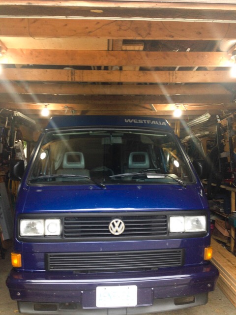

how high can i move rafters?

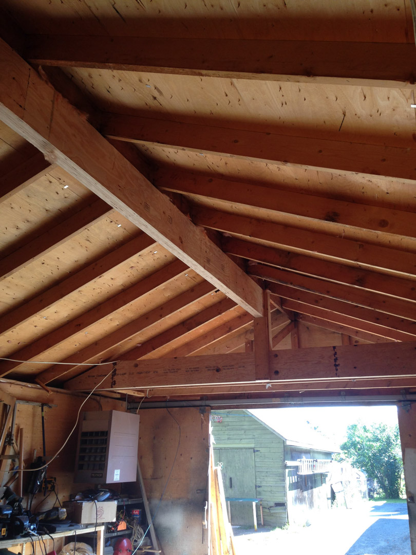

This is a perfect case scenario for a ridge beam. See my thread, page 1. Removed the collar ties completely and restructured in place with a ridge beam. About $600 of LVL beams and installed myself. Spec was from a local truss manufacturer:
https://www.garagejournal.com/forum/showthread.php?t=263351
I removed collar ties spanning 16ft of the 24ft shop. You'll need a ridgebeam, and two more LVL's to carry load to side walls. Side walls will need jack studs added to increase load bearing. I honestly did the basic structural work in about 6 hours.
Before:
After:
We have high snow loads here (about 60lbs sq/ft, 23000 lbs for this roof), so the spec for your application may be less or more depending on span, location etc. My shop is smaller and lower than yours, however the feeling of space with an 11ft vault is pretty transformative :) I had the ceiling completely sealed with closed cell spray foam, therefore no soffit venting required.
You can then redo your door rails to follow the ceiling, or replace with a roll up door, which was my approach. Another benefit of doing this is that you end up with lofts at both ends of your shop for storage...which may or may not require sistering up the leftover collar ties.

Have you considered lowering the floor? Seeing how ideas are being thrown out there....
I like the ridge beam...but, I don't see how you are going to get one in there.
But I must ask...how tall is the truck and your hot rod? If the truck is 6'....and the lift takes up about a foot of vert space....a regular sedan should fit under it

You completely remove truss ties and ridge beam sits under existing ridge board as my pics above. The cross beams just run across parallel to the existing cross ties that you leave in place (or not) at both ends. It's actually easier to run a full length ridge as opposed to what I did, leaving end loft storage. You should leave a few truss ties in place during construction to keep the walls from bowing out, and it also makes getting the LVL pieces up easier. We just used cargo straps as the LVL components are not that heavy, and can be assembled in place. You'd likely need 3 or 4 at whatever height they spec. (likely 10 or 12") Each piece is 1 1/2" thick.

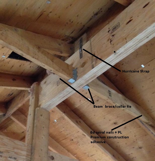

Ridge beam is the preferred , although expensive fix. A collar tie will do just fine. Here is a picture of my shop carport framing, originally built this way. The same framing continues through the enclosed portion. Plenty strong.ffaf1e9183136a0e696d63fa4e84d5b2.jpg
You do realized your in Florida and the OP is in NJ right? Roof loads where he lives is entirely different than where you live.
