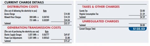

jpcjguy
Jan 6, 2014
1,480
Richmond, VA
Whoops! You are correct. :)
Here is my breakdown from my last bill
Tracs
Feb 1, 2015
569
Manitoba, Canada
Your cost is almost $0.11/kwh, that's pretty high.
Higher SEER doesn't mean its gonna break down and cost more money to fix.
You are saving $1000 on installation. Spend the $164 per unit and get the better units.

mike93lx
Dec 9, 2013
37,957
Richmond, VA
11 cents is not high at all compared to most of the country. It's actually well below the average
