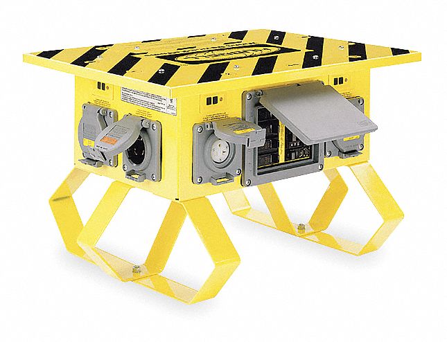

What are you planning on using the circuits for?
Mostly I'm going to split it up even further into 20A 120V circuits with a spider box.
Let's be clear here. Are you referring literally to a PORTABLE Spider box, such as:
http://www.grainger.com/product/HUBBELL-WIRING-DEVICE-KELLEMS-Box-4D572
4D572_AS01
Or are you talking about tapping off multiple permanently installed 20A/120V circuits from that single "feeder", in some sort of home-brew work box?
In the former case, the spider box would be considered ONE load; and what you run off it is purely a matter of the box's capabilities. That said, the circuit feeding the spider box must be capable of the full load that box could possibly impose. In the case of the example cited above, that would be 50A @ 120V.
In the latter case, you would need to install a proper sub-panel to support the branch circuits.
Also will occasionally plug in an air compressor. I already had the wire so....
That further complicate things; but it doesn't fundamentally change them. The main thing is, if you're using the circuit for the air compressor, you cannot simultaneously use it for the spider box (and vice versa).
Besides, if you have an air compressor which needs 30A @ 240V, it's likely to be permanently installed anyway. So then, it's power feed should also be permanently installed, and dedicated to it (and probably hard-wired, for reasons we have not yet gotten into).
Yes, I have a 30A box. (The original twist lock cord has been replaced with a 30A dryer cord)
