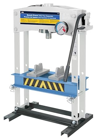

I own one of these. OTC 5230. Bench top model. 16.5 tons. More than the size it is the quality that counts. It's the pride of my shop. Have used it to rebuild a couple of BMW motorcycle transmissions. Almost paid for itself after one year. Letting friends come by this year to rebuild their transmissions and I'll guide them.
I owned a Harbor Freight press some years ago. It was junk.
I'd like to know more about that press, price etc. Like you, most of my projects are motorcycle related and I don't have a lot of room. That press could be out of the way when you didn't need it.
