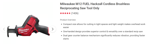

It's really a question of "How much patience do you have?". :dunno:
If you're considering a new M12 tool, I'd be looking at the Hackzall:
Or the Band Saw:
Pricey for my needs, but I really want the band saw! :love:
