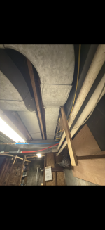

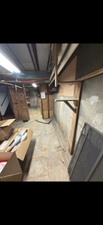

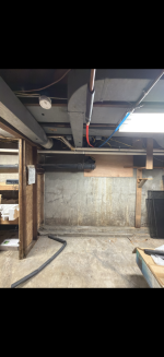

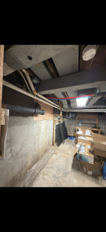

I'm adding a 125 gallon aquarium in my living room along an exterior wall, and this will generate about 1300 lbs of load for a 9 sq ft area so about 145 lb/sqft.
The length of this aquarium is unfortunately parallel to the joist and I think it's also only going to span this single joist, so I would like to had structural support under this joist. The aquarium is 6' long and about 19" wide (about 9 sq ft surface area)
The house is a 1927 tudor.
Here's a video showing the joist for which I would like to add a structural support:
Here are some pics:
IMG_6367.PNGIMG_6375.PNGIMG_6374.PNGIMG_6373.PNGIMG_6372.PNGIMG_6371.PNGIMG_6370.PNGIMG_6369.PNGIMG_6368.PNG
The joists are about 1.5" thick and 9" in height.

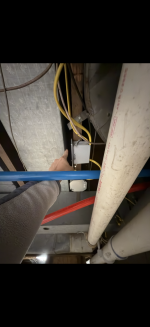

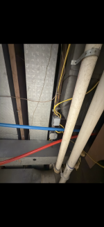

As you can see from the video and pics, there's a lot going on there... electrical, plumbing, HVAC ducting....
There's not a clear exposed portion of the joist under the aquarium's footprint where I can get a support beam in there. The direct vertical path between the joist and the ground is partially blocked by electrical and the PVC pipe. The electrical is probably easy to move but not the PVC pipe.
How can I go about adding structural support like a jack post or lally column? Would I have to move some of the stuff around to get this to work?

I think the tank will sit on 1, and at most 2 joists (the 2 shown in the video). I'm not positive it's going to go all the way to the 2nd joist.
It seems what you're suggesting is I should get some wood block and fasten it to those 2 joists horizontally, and then at the middle of the would block, I can put a vertical post that transfers the load to some bottom plate (ideally one that covers are large surface area)?

How much time do you have? I did the same project when my wife bought a 250 gallon glass tank + all the sumps. Landed on one joist, going parallel, just like yours....of course that's where she wanted it!
I'd pull down the HVAC (temporally) and add additional 2X10s across the span. Nail/glue/screw them to the existing will create a beam. Then replace ducts. I did the load calcs when I did mine, but over did it.......Lumber is cheap, put up as many as you can fit.

Is there room to put posts under the joist, and can you live with them taking up space?
definitely can live with them taking up space.
in terms of room, it depends on where under the joist. in the area under the aquarium, there's limited room (but see my comment above). outside the area, there are some free spots where it won't be an issue to get a post under there, but I think the most optimal place would be be somewhere in the middle of the aquarium, which would be just to the right of that electrical junction box (the one you see fastened to the joist)

Is there room to glue and screw a 2x4 horizontally under the joist like the lower portion of an "I" beam? Then run a 4x4 post to concrete somewhere near center span of the tank? Also you might want to think about putting a 3/4 piece of plywood under cabinet to help distribute load.
What floor do you have? If its hardwood running perpendicular to joists you may be OK provided ends are sitting on joist supported by foundation wall.

You outa clean up the romex…and no proper fittings going into a metal box is no bueno as well. Then either pour a few pads/use anchor blocks and add a double 4x4 and tie it all together with some Simpson brackets. If you are feeling frisky…take a 4x6 and set that under the joist (in areas where it will fit) and support that with 2 or three posts…problem solved.

I'm sure it won't fail. The question is how much more will it deflect. Put in something to measure - a stick or pole or use a laser - and load up the floor.
If you halve the span of the 2x10 you nearly double it's bending load, so a post near the middle of the joist would be the most you need. A lally column - aka adjustable Jack post - would be simple.

I'm unfortunatley new to homeowner and don't know much about this. What's wrong with the romex an dmetal box?

It shouldn't matter. I said cutting span in half doubles the capacity but I should have said it quadruples the capacity. Bending moments ares an inverse square regarding length. So if the joist supports 40 psf - normal design for a living room - the floor supported by the joist with added support at center should support 160 psf.
Center under tank would be fine but if obstructed by pipes, ducts, whatever, it shouldn't matter if not directly under tank.

I don't see another joist past the one in question (the cluttered one with the junction box attached to it) in the direction of the foundation wall. I think that one might be the first joist starting from the wall?
I ordered a jack post. I'm not confident I'm going to have a straight vertical line between the bottom of the joist and the ground, given the stuff in the way
