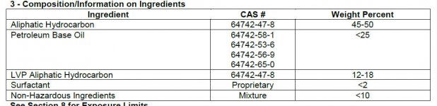

I don't think anyone outside of the company really knows what is in WD40, but I've never seen it hurt anything. It is the safest cleaner I have ever used and the solvent I would always start with when trying things. It works beautifully on flat black plastic notebook computer cases, I can assure you of that.
39,593
http://www.wd40company.com/files/pdf/msds-wd482671453.pdf

Slept through basic chemistry Mark? You do know what a hydrocarbon is? How about petrolatum based oil? :wtf:
My point was that WD-40 has oils in it, and you don't want to go spraying oils on a flat painted surface. (do what you want with your stuff however...)

Enough with the smart ***, I have a feeling I had a bit more chemistry than you. I still don't see any kerosene. It seems there may be quite a few petroleum based oils that are not kerosene. In fact, I'll wager that there are millions - maybe an infinite potential number, really - of hydrocarbon molecules both real and theoretical, and you think that this one is kerosene because it is a hydrocarbon. OK, you've got me there. I bow to your superior knowledge of chemistry, otherwise known as speaking out your (*^(*.

Kero or not, I don't think WD40 would be a good idea. My experience has been that once the carrier evaporates, the remaining tends to attract and hold dirt.......

What does WD-40 contain?
While the ingredients in WD-40 are secret, we can tell you what WD-40 does NOT contain. WD-40 does not contain silicone, kerosene, water, wax, graphite, chlorofluorocarbons (CFCs), or any known cancer-causing agents.
http://www.wd40.com/faqs/
How does Crow taste? I hear it is not bad if cooked at 400 for 4 hours, basted with alpiatic hydrocarbons and doused in Frank's hot sauce. Eat up Mr Badlands.

You are the one that misquoted me, I said kero/oil. I put it that way as there have been several claims over the years that WD-40 has been analyzed and its at least partly Kerosene. I tend to believe it, but have no direct proof. What I do know is that the MSDS clearly states that a significant portion is oil.
And this A sure sign of an oily residue...

Eat what up? WD-40 Corp propaganda? Ever heard of deliberate misinformation? Got an independent source that is free of ulterior motives? :bounce:
39,593
Here you go mark, we are even; my useless internet reference cancels out your useless internet reference.
>As I don't recall seeing a decent answer yet in this thread, I shot
>some WD-40 into a vial of ether and then shot the sample into my GC-MS.
> This minimal analysis will have missed any nonvolatile species
>(inorganics, polymers) as well as any components (propellants etc.)
>with approximately the same volatility of ether (the detector is shut
>off during passage of the solvent front). I then matched some of the
>major peaks against our computer's 138,000 compound database.
>The GC-MS shows about 45 different components in the C9-C11 range.
>Decane and undecane are the two largest peaks in the spectrum. Most of
>the C9-C11 appear to be straight or minimally branched hydrocarbons,
>although one peak had a pretty good match for decahydronaphthalene.
>C9-C11 make up approximately 99% of the detected signal, but I also
>picked up a small amount of higher alkanes such as hexdecane and
>eicosane (C16-C20 range). Overall, it doesn't quite match Merck's
>desription of kerosene, but the idea is more or less the same.
The kerosene reference was in response to another reader's suggestion.
Bruce Hamilton also pointed out that if there were any non-volatiles
you could easily test for it by evaporating the solvent.
Enjoy.
Rob
http://yarchive.net/chem/wd40.html
Now can we stop derailing the thread on this useless argument and let the OP have his thread back?
