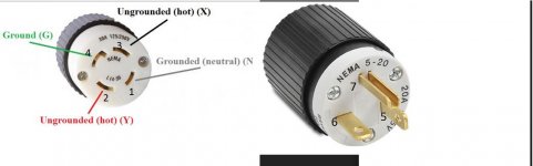

Thank you so much guys, especially Alhymist, Bgeery, Nich, Tommy, and everyone who keep this positive.
So I bought everything already. I got the Reliance 6 circuit, see the installation on youtube. Pretty easy.:bounce:
On the wires, can you please let me know which to hook up where?:confused::headscrat
2&3 bridge to 5 (hot)
1 to 7 & 4 to 6?
or 1 to 6 & 7 to 4?
Thank you so much!! :thumbup:
bgeery
Jul 2, 2013
43
Yucca Valley, CA
1 to 7 & 4 to 6?
or 1 to 6 & 7 to 4?
7 to 4 (Ground - Green)
6 to 1 (Neutral - White)
5 to 3 and 2 (Hots - Black and Red)
(ABOVE CORRECTED)
Only use with the small 2Kw generators, if unsure about the existence of MWBC in the house. Use a Kill-A-Watt meter to find out how many Volt-Amps your current equipment draws. Start upgrading your electronics and appliances in the future, with an eye for energy efficiency and good power factors.
