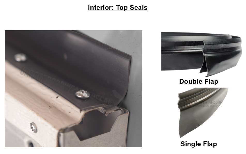

Interior Top Seals
I stumbled across these things a few years ago - before that, I didn't even know they existed:
There are different styles available. Again, I have tongue and groove door garage door panels, so the pictures shown are specifically for that application. They also make ones for flat top/bottom door panels. I went with the double flap variety since the cost wasn't that much more.
These seals work pretty well at sealing the top of the door from the inside. It's especially nice since they attach directly to the door panels, so there's no worries about pinching them like you would if they were attached to the wall.
That said, you do have to watch where they come close to your torsion springs. The first couple times I used it, the end of the torsion springs that stick out were getting caught on them. If that happens, you'll see it, and probably hear the racket as it catches and lets go. All you have to do to prevent that is make a couple well placed slits where it makes contact with the springs - problem solved. I'd highly recommend running the door up and down manually after installing these to watch for interference before you re-engage the door opener.

38Chevy454
Dec 26, 2006
4,038
Cincinnati, OH
Re: Interior Top Seals
I just installed this top inside single flap seal on my 16ft wide doors. They were bowing out slightly in the center away from the frame and outside seal. I could feel the cold wind blowing in before these seals blocked that. Has to be helpful on the heating bill :eyecrazy:
https://www.garagedoorstuff.com/product/garage-door-top-seal/
