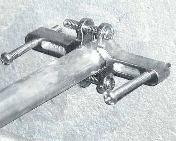

You the man. I found this that should work great!
This piece does look perfect, obviously stops it from pulling out but then if you make small holes for the set screws to set into the block it won't rotate either.
No messing with mounting screws in the front brick fascia on the tiny outer flange! I think I may order one of these and give it a try, although they may have them at lowes and I just didn't notice them there before.

problem is you have pex and nothing is going to really work , not even that neat little doohickey . best advice you will get is pull out the bibb and pex and make the piece thru the wall copper tubing and then either you can use that doohickey shown above or a reg copper plated riser clamp or just strap it too the wall. pex is too soft and nothing will hold it well.
if the inside wall is going to be left unfinished this is fine . if you never be able to get to this in the future i suggest ditch the sillcock and put a female adapter a little out from the wall,and use a boiler drain this way when the hose bibb starts to leak it is easy to replace .

I ordered the piece pictured above. The spigot is actually attached to cpvc through the wall. There is a 90° elbow in the wall that transitions it to pex. So that part will actually attach to the cpvc. It will work fine, I just haven't had time to install it yet!
Thanks everyone.
Edit to say I just finished the walls inside not that long ago and put in an access panel for easy repairs. Worked out for me already!
