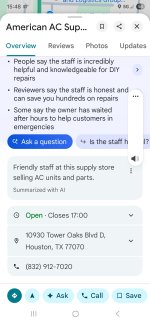

I wish. The one I’m familiar with won’t sell to public.
Well then familiarize yourself with one that will.
This guy will sell any part you want. Not sure where yout at , hes in NW Houston, Jones rd and fm 1960 area.
