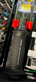

My Vessel hand hammer impact wrench runs 5/16” bits. Only time I’ve damaged on was way back, post 1981, mangled one of the Phillips bit when I didn’t hold the tool tight enough prior to impact. I recently bought a couple of spare Lisle bits when I lost one.

I have a Koken attack driver which uses/came with 5/16” bits. It reliably does rotor screws in one shot, anything stuck in like that where you just need to break it free and don’t want to wail on it with an impact gun
Damnit, I just bought one too:
I didn't take the bits out of the sleeve or use this yet, but they are 5/16" bits. IDK why I assumed these were just reinforced 1/4" bits. It's obvious to me now. If I had know he was going to need it, I would have loaned it to him.
@superautobacs, do you use the Koken 5/16" bits with a "handheld" impact driver like the above, or "power" impact driver (air/electric)?

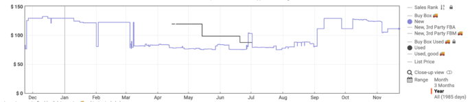

The domestic USA prices for a Ko-ken driver with 16 bits have fluctuated a lot this year but have been quite reasonable at times.
I like this better than the Vessel version. The Koken appears to be even more heavy duty.

I have the 1/2"sq Attack, but rarely use it. I have a mishmash of Wera and Ko-ken 5/16" bits in in-hex and torx. They are inserted into dedicated bit holder and get driven on an impact wrench.
The #3 shattered because I didn't fully seat the bit into the screw.
The T45 got ruined from repeated use, driving it on the end of a wobble extension.
Ko-ken has a few double-ended 5/16" bits as well and a dedicated bit holder.
