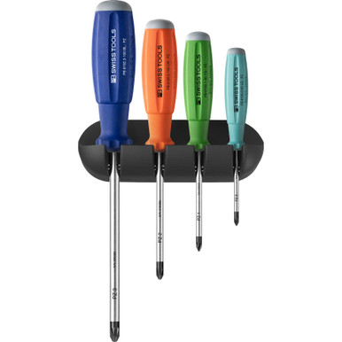

Good thing there is PB Swiss :)
In all seriousness, the Kraftform handles are polarizing and that's okay! Some people really love them and some do not. Is it the shape or the material that's not for you? I do feel there could be room in the Wera lineup for a secondary handle option for those that like the blades, but not the Kraftform handles.
Ohio Andy
Jul 31, 2024
2,475
Columbus, Ohio
Yeah it's just the handle shape. That's it.
I think the drivers are amazing. They really grip well they hold up well. I just don't like the handle.
I've kept them around because they're my only set that are full drivers without using bits that have pozidrive.
And even though I own probably 10 or 12 other sets, none of them have pozidrive. Because I have sets in different locations, I track them all, and my records show that I have 58 pozidrive bits spread across all my bit sets. So it's not that I have trouble finding them if I really need them, but, I like to have one set with handles so I don't have to find the bit, put it in a driver when I just need one quick in my primary shop.
So is time for me just to buy something that I like. And I really like the PB Swiss handles. Of course, PB Swiss has two different sets that I like. But I decided to go for the pretty rainbow colors. I didn't want them to blend in with my other DB Swiss handles. So it was either that or the hard blue handles.
And while I was at it, I figured I'd order some e6 bits from PB Swiss. I have a ton of PB Swiss bits, but most of them are C6 size.

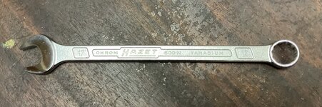

With regard to Hazet and Stahlwille, if we are talking wrenches here (the answer would be different with other tools) then realistically, either are very good.
The tools are very different in appearance. The Stahlwille are overall satin finished (proper satin, not a crappy matte that some others call satin). Hazet are part matte, part polished.
The Hazet are fairly resistant to wear, certainly on the matte areas. The Stahlwille actually seem to polish slightly in use. Neither show marks from use that a polished Snap On would.
Stahlwille feel different to other wrenches. The steel feels lighter but they are very strong and springy. The more you use them the more you get to like them. Hazet feel heftier and harder.
As regards open enders, there’s little to choose. I probably slightly prefer the Stahlwille (because Hazet don’t polish theirs at all) but I’d be happy with either.
For short combination’s it’s hard to choose. See above re different feel. I have a rack of Stahlwille above my bench as my “go to“ and they’re great. Have a few Hazet in one of my vehicles, same applies. Note the different offset and choose which you prefer.
For long combinations I think the Hazet win - so much so that I can’t show you a comparable Stahlwille. They win largely because I think the slightly stiffer open ends of the Hazet are slightly better suited to the longer wrenches. I just love the feel of these too.
(A member here pointed out these are dimensionally identical to the old Britool “inset panel” RBM series - no bad thing). These are also available in an extra long version, which Stahlwille are not,
For box end wrenches I slightly prefer the Stahlwille. In fact, I have a load of these and also use them as my “go to”. The Stahlwille have “off corner” engagement, which the Hazet box end do not, and Hazet have now discontinued the shallow offset No.625, so if you want that it has to be Stahlwille.
Having said that, the Hazet do have “some qualities” about them, and they really do inspire confidence. Both makers offer deep offset.
The short / thin, zero offset, wrench seems to be an exclusively European pattern. I only have a few of these, Stahlwille only in Torx, but I prefer the Stahlwille. The Hazet are a slightly odd shape.

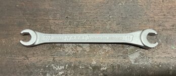

For flare nut wrenches it’s Hazet every time. Very solid, and a wide selection is available. One if the few flare nut wrenches that comes close to Snap On. Special brake line versions (very strong) are available.
Hope that’s useful.

The Hazet 603 are nice and I like the offset box, but the 600N/LG have the “off corner” engagement. The 610N short box end also have the "Outside hexagon Traction profile" “off corner” engagement.
Dave455
Mar 19, 2013
5,859
Sussex, England
Yes, it’s only the 625 and 630 that lack this.
I didn’t make that clear.
