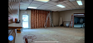

Contractor started the remodel yesterday. Biggest thing is cutting in two large roll up doors. Other stuff is removing the carpet, opening up two interior walls, patching some ceiling drywall, and pouring a concrete ramp between the two elevations.
They used the scissor lift to peel the carpet back.. pinching the carpet in the scissorayers.
I’m still a little blown away at how well this worked. In two days the carpet is all out and hauled off, ceiling drywall ready for patching, both walls opened up, and more.
End of day yesterday:
And today:
I’m excited to see how far we can stretch the current budget. Lots of work, and it’s going well.

The contractor made a lot of progress in the first week. Sounds like they are going to grind the carpet adhesive off the floor with a finer grit. The floor is in pretty good shape overall with some spalling here and there. They got one of the roll up door openings cut in with a temporary buck while the doors are being made.
There was rebar in the wall. Very happy seeing that.
The opening will get steel similar to what they did on the Bldg 2 door project.
Security cameras cover each opening from multiple angles on both sides.
Then they spent the last two days getting things ready for the forklift ramp between the two elevations. They cut out about half of the area so the lower part of the ramp will have some thickness.
The ramp ends up 13.5” of rise over 12’. 15’ wide.
There’s a lot of rebar, tied into the existing concrete. Should be a great forklift ramp. Sounds like 6” thick minimum with thickened edges all around.
