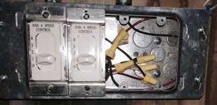

The second ceiling fan arrived today. These four gang boxes arrive tomorrow. Then I can pull in the wire for the ceiling fans.

I got the ceiling fan and Liftmaster remote light receptacle heated up tonight in bay 3. Bay 2 will follow soon. This conduit run also puts quad 20A receptacles on the wall by the roll up doors and the openers.
The fan is the Home Depot 60" Industrial. It moves a lot of air, is VERY quiet and includes the four speed wired controller.

Bay 2 fan and wireless light is finished. I am really happy with these fans. Found a four gang box on eBay for a tiny fraction of what it would cost at a distributor. This will have four fan controls in it when finished. It's nice to get these things going. The shop is going to be exactly what I have always wanted!!
