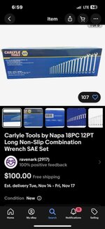

The Carlyle are available on ebay from seller "ravenark" for amazing prices. I can't say that I've used mine much yet (just got 'em last week), but they sure look purty, and they seem to be well-liked here on GJ.
This…….I got the large SAE set for $100. Cannot beat these sets for the money. IMG_0449.jpg

I just bought both the metric & SAE sets from "ravenark" yesterday. I already have full sets of Carlyle wrenches, these will be for a second toolbox in a different truck. You just can't beat that price for those sets. I really, really like my Carlyle wrenches. I swear those sets were $80 a couple of weeks ago, but cant prove it. But still, at $100 & free shipping.......
