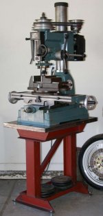

This one is old. I built the top from air-dried rough sawed rock maple that I milled and glued-up while working at Tyler Mill Works furniture factory in Athol Mass in 1975. It's 10' x 2' x 1 3/4"thk. It was originally a kitchen counter in my NH cabin.. When I left the cabin in 1978, I removed it for future workbench use. In 1985, I bought several 4" x 10' steel structural C-channels for a dollar a length because they had ben under salt water and were pitted. The first photo was the original construct and the second is recent augmentation to enable storage of my 600-700 lb lathe.
BTW that looks like a Woden or Record blue vise. I have a 1950's Woden shown in another post.
Here is another table, originally built from the same C-channels in 1985 for welding and when bolted to the garage floor, for bending. I built larger weld tables fifteen years ago and retired it as a mill stand. Can't throw away good art.
