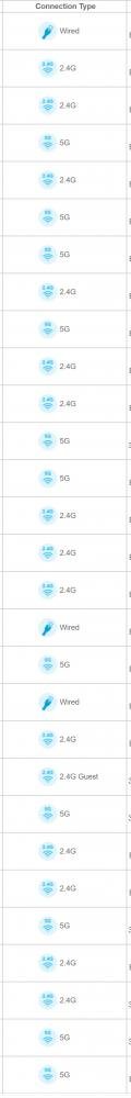

I am currently using a 3 piece Orbi Mesh system that I paid $400 on sale from Costco in January. Works great, excellent coverage throughout our 4,000 sq foot home and backyard. They currently have a newer version on sale for $440. If you are not currently a Costco member you can buy a 1 year membership through Groupon for $60 and get a $40 gift card and a $40 credit at Costco.com - so you actually make $20
https://www.groupon.com/deals/n-cos...E22D4882_ED837B7E-EB76-426A-A387-7801A2568DD3

I don’t believe the Orbi works with devices that run at 2.4 GHz. I have a wireless printer that requires such a connection.
With my Orbi, out of the (29) attached devices on WiFi, (15) of them are using 2.4 GHz. Honeywell Thermostat, Lennox Thermostat, Epson Printer, Rachio Irrigation Controller, and several Amazon Echos and Rokus.

Thanks. I’ll check it out again
