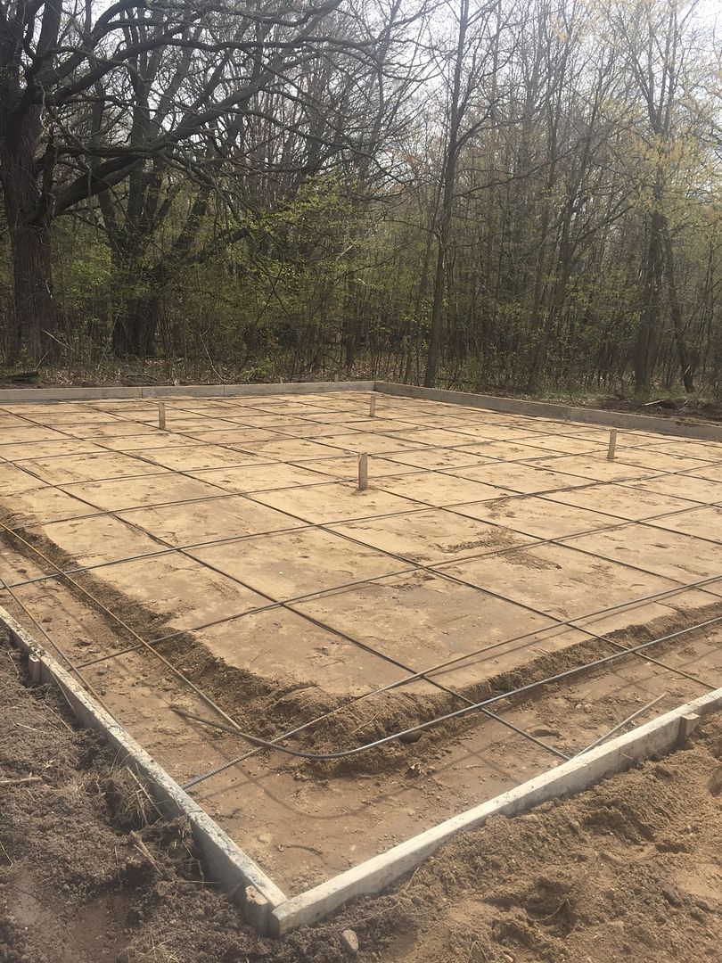

I've lurked on here for a few years and have dreamed of building a shop.
My wife and I moved to her home state of MN last year and purchased a foreclosure on 4 acres and are finally getting started on remodel and shop build.
We got our building permit on Monday and the crew started digging on Tuesday.
Elevation
Floorplan
After cutting a few trees to clear the spot.
They had to bring in about 100 yds of fill.
Formed up to pour the monolithic slab.

So I am curious if that's a "frost protected shallow foundation" that's going to be perimeter insulated to prevent heave?
Other than that, good to elevate as you did on what I think is a pretty flat site.
My recommendation is for a vapor barrier, 6 mil minimum, which I don't see in the pics.

Welcome to the Northland, I'm sure you'll get used to the sub zero weather soon enough!
I am surprised that they didn't put any vapor barrier and then insulation in top of that.
I just got done building my house in northern Wisconsin, they did the same type of foundation (perimeter footing... Not a technical term) I guess it's found to be just as structurally sound and cheaper than traditional footings.

Thanks guys.
I know the vapor barrier isn't required by code, but I asked my builder about his thoughts on using one.
I have no intention of using a epoxy floor coating in the shop so I didn't think anything of it when they didn't put one down. I have a few days before that slab is poured so I have time to get one in though.

Dave, as you're in MN, I'd strongly consider insulating the slab, even if there is no radiant going in. It will make a big difference if you plan on heating the shop! You'll also see less condensation on the surface on those humid summer days...
