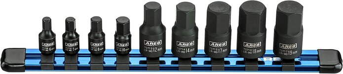

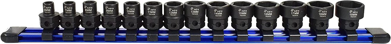

Absolutely. I can share some additional examples on this topic, and I will provide pictures here where I can. I have a few sets of sockets:
1. Astro Nano sockets. I have the 3/8 drive metric set, and these are impact sockets. This is a socket I cannot find in chrome, but got close with the OEMTools chrome low profile socket sets. This provides me an impact set that is not really available in chrome. I have the OEMTools low profile socket sets in both metric and SAE.
2. ARES 70496 and 70497, metric and SAE hex bit sockets, machined from solid piece of CR-Mo. The profile of these sockets makes them valuable to me, as in the chrome options, I cannot find the same.
In those examples, the impact variety provides me with something I cannot find in chrome versions. I am not really a fan of impacting bit sockets, especially on the smaller sizes. However, the items above are only available as impact. Why are those not made in chrome? The walls are thin on the sockets, and the sockets are smaller than the OEMTools low profile chrome sockets. For the hex bit sockets, it is hard to find something that low profile in chrome, but why, for example, does no one make a similar socket machined from S2 steel or CR-V vs impact hardened CR-Mo?
It seems like the market pushes me to buying impact sockets for hand tools. I am at heart a person of science. I like to know the how and why for things, even while most will say "who cares". While I agree that many times it really does not matter, I like to fill in the knowledge gap. I hope that explains my query in more detail. There must be some logic here, as manufacturers do not do things for no reason. They are either trying to save thus making more money or catering to a specific market, but there is always a reason.
The images below show 1) the Astro nano sockets, 2) the OEMTools low profile sockets and 3) the ARES hex bit sockets.
