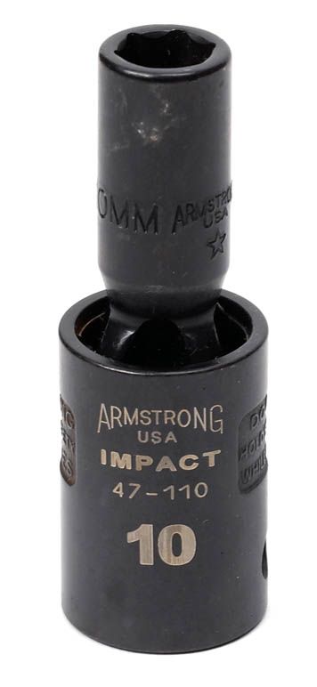

Another good choice would be Craftsman Swivel Impact Sockets/Armstrong Maxx Universal Impact Sockets. Identical except for the name on the laser etching. Both are pinless, pretty damn rugged, lifetime warranty, USA made, and priced a hell of a lot better than the truck. We have a mix of both at work that I use pretty often, and I'm slowly working on saving up for some sets of either. Honestly, really no point in paying truck prices for these unless you want/need the pay over time.
Only thing that ***** though, is good luck finding the Armstrong ones online. Seems almost no one wants to carry them.
Craftsman (3/8" Drive):
00915360000
Armstrong:
00974381000
And here is a brochure for them https://www.armstrongtools.com/brochures/P9-168.pdf from their website.

Unless someone has a better source--I have found that Amazon carries more of the Armstrong line than anyone.
Steve_P
Sep 15, 2010
5,185
Google the PN. I bought a set of the armstrong pinless months ago from a strange source- some type of cleaning supply company! They had the lowest price; they weren't in stock and it took ~2 wks for me to get them - which was fine with me.
